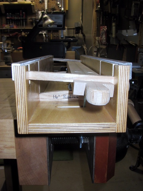

I bought the plans for this jig from Luthiers Cool Tools. I chose to build this jig because of its small footprint and robust design and construction. The plans are clear, concise and understandable. A bill of materials is provided as well as sources for the hardware and components. I bought most of the hardware from local sources. Bearings and UHMW polypropylene were purchased from McMaster Carr and the router bit was purchased from Rockler. Included in the plans are radius templates for inserts that will produce 12”, 14”, 16”, 18”, 20”, 22”, 24” radii. The jig is capable of producing compound radii on fretboards. It is constructed from ?” Baltic birch ply for the frame and hardwood for carrier board, guide blocks and bearing mounts. The router rides in a track bordered by aluminum angle stock.
This shows the jig mounted in a bench vise ready for action.

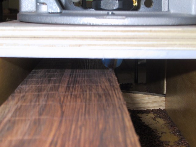

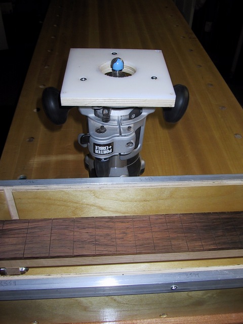

I made a simple square router base lined with UHDMW polypropylene to allow the router to slide securely and freely within the track. I found that the round base was too easily tipped and bound as it traveled. The router bit is a 3/4" core box bit from Rockler.

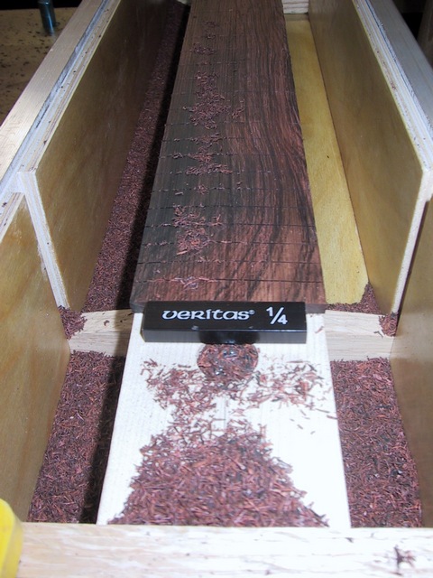

This shows the FB half done. It took about 20 passes to get this far. I indexed the carrier board about 1/16" for each pass.
This is the completed board. Just a light sanding with 100 grit was all that was needed to smooth out the machine marks. I used the 1/4" setup block to adjust the bit height before starting the operation.

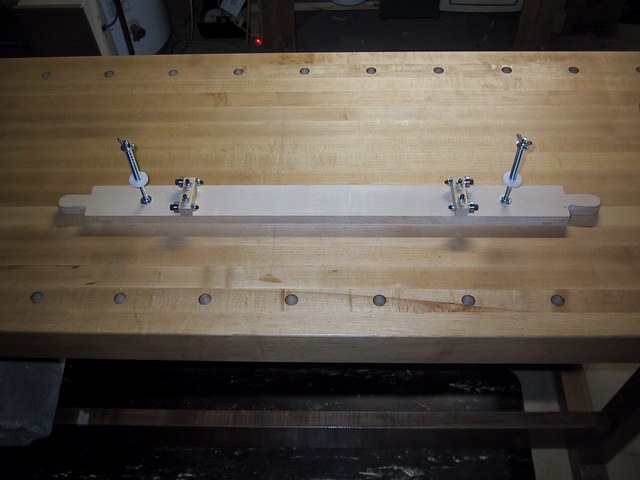

The jig was quite simple to build. It's very important to dimension the carrier board perfectly. It must be straight and dead flat. I chose to use 7/8" hard maple for this and had my Amish buddy joint and thickness sand it until it was just right. The results were that the first board was dimensionally uniform on from end to end.

What hardware connects the inserts to the carrier board?
Could we get a look at under the carrier?
How do you secure the FB onto the carrier?

Just to make sure I'm understanding it correctly ... the router rides on a flat guide, and the fingerboard carrier is hand-held, sitting on the radiused guides on each end and then moved back and forth across the width of the fingerboard. Right?
For the sake of the next question, picture the jig in front of you with the fingerboard oriented left-right. To use it, you'd push both fingerboard sled handles away from you and toward you. What inaccuracy is introduced if the left and right handles are not perfectly in sync - that is, if one handle is further forward or back than the other?
Thanks for your help in understanding this baby!

lookin' good! I'm planning on building craog holden's jig, but if this one works well, for a much smaller footprint (my shop is tiny; 15'x7', ish), it's certainly worth considering. Craigs will have to wait until I trade up in shop size :)
Far as I can tell, its a box with radiussed inserts that slot in, with ball bearing runners (two each) running along the radii. Are the covering 'slats' at the two ends to hold down the carrier board while routing (longitudinal direction)? I've drawn up similar plans before, but its the locking down that always stopped me from building one like this. Have you tried it with a compound radius board (lets say an extreme-ish 12-20" progression, which I want to try for my electrics)? how do the bearings deal with the longitudinal diplacement involved in a compound radius? Is there much/any? Does it take fingerboard thickness (even down the edges, not down the center) into account?
Final question, comment: why a cove bit? I would think a 1/2-3/4" flat bit wold be faster and cleaner; my current rig uses a 1/4" flat bit, works well.

Good lookin jig JJ, it takes up a little less space than mine. Good call on that square pad. That was the only reservation I had about your original design.
I use a 1/2" dovetail bit in mine because it was the only carbide bit I had that had a flat bottom. It takes me about 6 to 8 passes to do a whole fretboard. It does not come out precisely smooth but a couple passes with my Stewmac leveler bar and some 220 grit finishes it off after the fingerboard is attached to the neck. John How39057.5338657407

Here's a shot of the underside of the carrier:
The 6" carriage bolts are connected to the carrier and pass through the base thtough 2.5" slots. They are held in tension by compression springs and wing nuts and 3/16" thick x 1.25" UHMW washers ride on the bottom of the base.
Wade...The FB is secured to the carrier by 4 pieces of 1" double sticky tape. The radiused inserts slide into a slot on the sides and are just held in place by the slots.
Pete...The carrier is indexed laterally while the router travels longitudinally. By tensioning the carrier bolts securely from below and being guided laterally via the guide blocks, the carrier actually indexes fairly evenly. It's always possible to take more passes than I did but it seemed to work well during my first trial.
Mattia... haven't tried a compound radius yet. The rounded bit works better for a radius than a flat bit, so I was told. I have, however, used a flat 1/2" bit to thickness a board...you just have to substitute 0 radius blocks for the bearings to ride upon. The flat bottomed bit works fine for that.

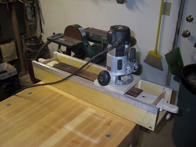

Here's another shot that might further clarify what's going on:

Chris...perhaps I didn't describe this clearly. The carrier is indexed 1/16" and then you take your hands off it. You then put your hands on the router and move it lengthwise. It's not necessary to have hands on both components at the same time.
